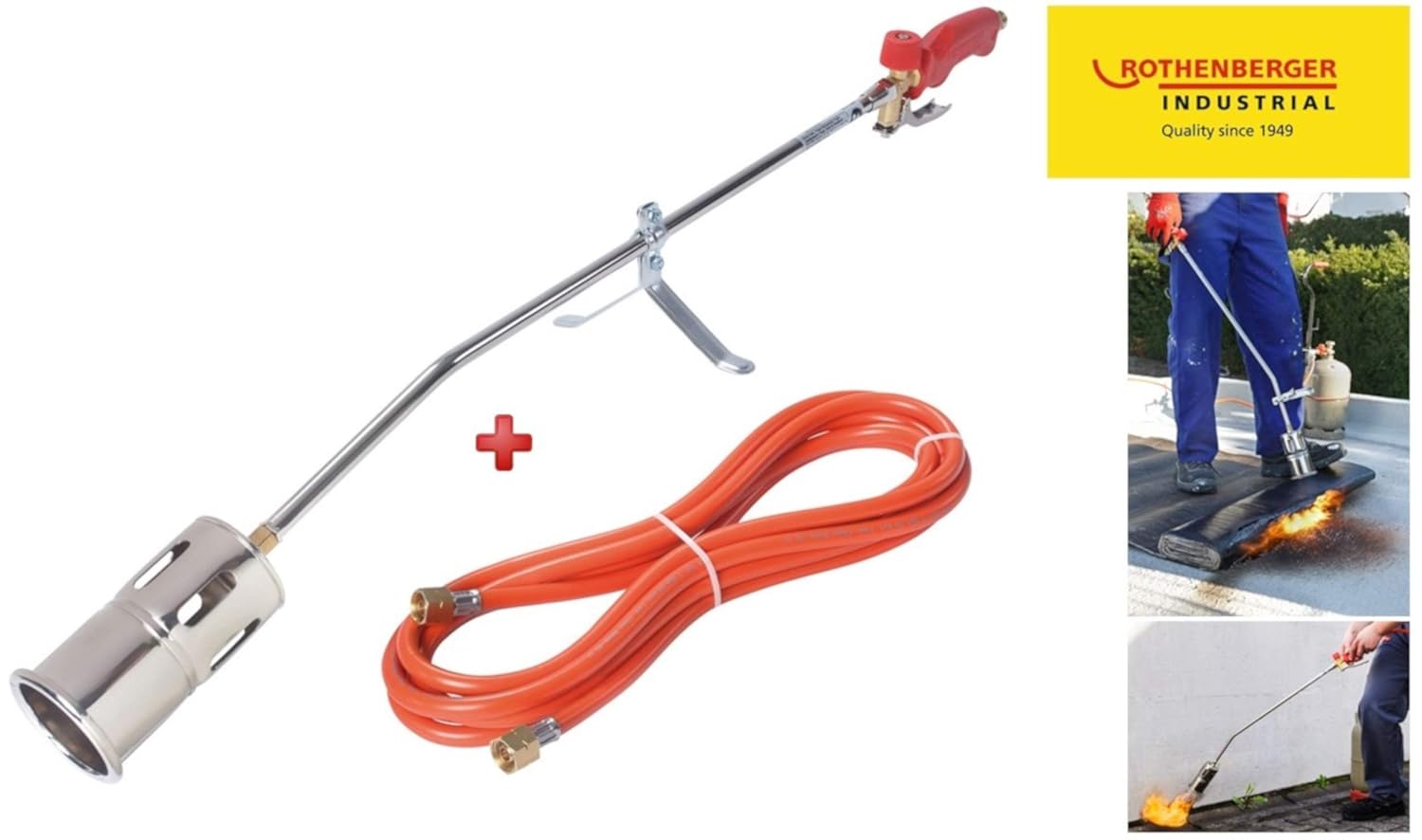

HI, i have just bought one of these:
Rothenberger 30954 Roofers Propane Torch Kit with 5m Hose , Multi-Colour
And i was hoping to connect it a Blue Calor gas bottle (butane) since i have a full one. But shopping round, all the regulators i can find are push fit, where's the hose has a screw end.
Any ideas if i can get the burner to connect to a butane bottle?
The only way to get it to fit will be to get the regulator for the bottles you have and adapt one of the hose to suit. A jubilee clip is not the answer by the way. There is a place on Trefforest estate that specialises in hoses and connections, near the Honeywell factory, I can't for the life of me think of the name though, if I do remember it I'll pm you.
