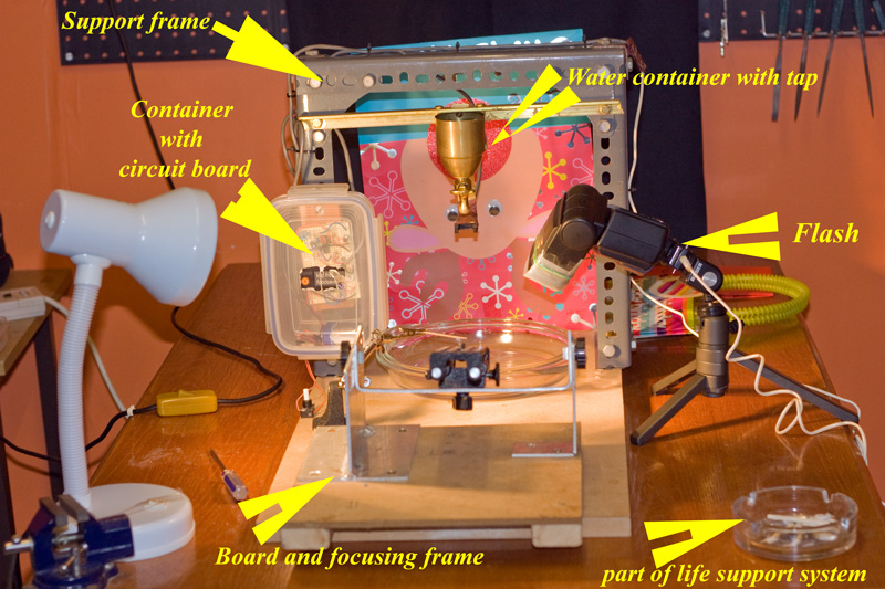

i have a trigger setup, consistent results so you have more scope for working on ideas and composition imho
easy to set up and wire it yourself, costs about a tenner from the states
http://go.talkphotography.co.uk/?id=722X1339&url=http%3A%2F%2Fwww.hiviz.com%2Fkits%2Fspg-du_complete.htm
here is mine

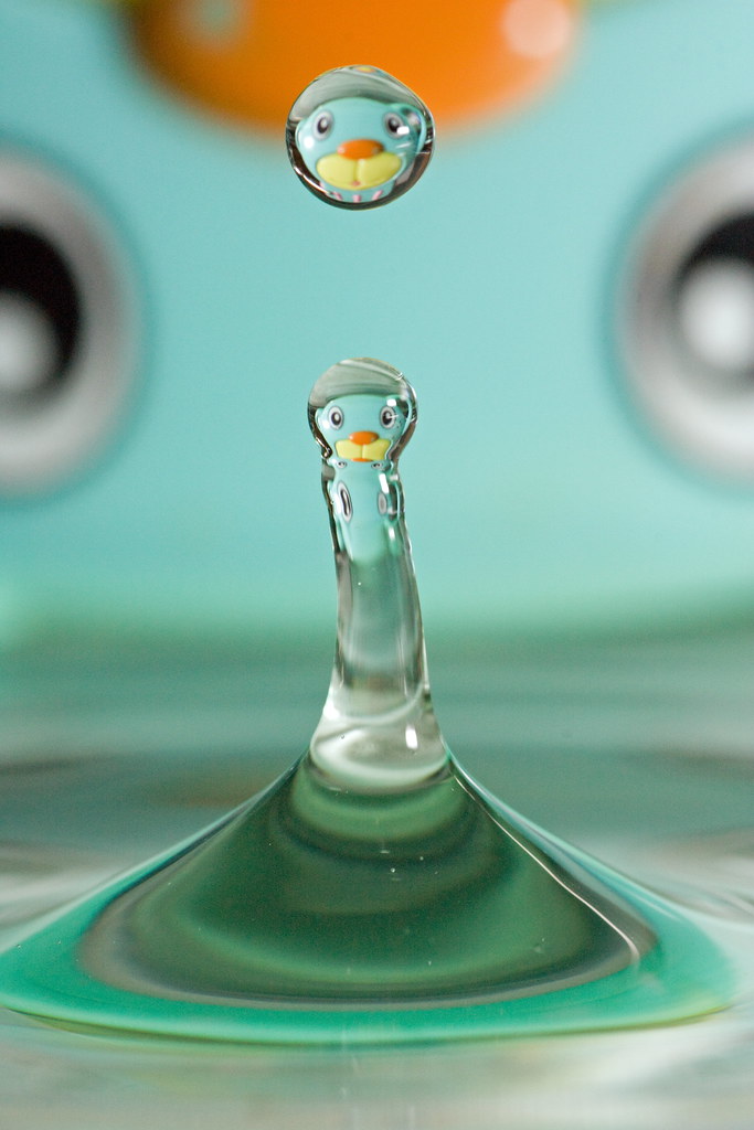

Animal, that's a brilliant shot! How come the water container doesn't show in front of the face in the drops though? Oh, and your flash support looks like its' about to head for the floor, as the back leg is off the table!!
