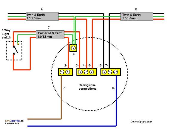

Have a look at this:
Power to the alarm should come from the centre contacts (live) and the right contacts (neutral). I think the neutral wire has been connected to the contacts on the left by mistake.
Steve.
Steve, that diagram is poetry in motion. If all were like that!
Probably less than 10% of ceiling fittings I have seen are actually wired like that!
In the OP's case though, I think the principal is the same. Alarm neutral connection going to switched live instead of neutral.

Good diagram...trouble is on light fittings installers have used twin and earth to go to the light switch and used the black wire as the switch wire from the switch back up to the light fitting and not red sheathed it and causes all kinds of confusion when the diy'er decides to put a new light fitting up
