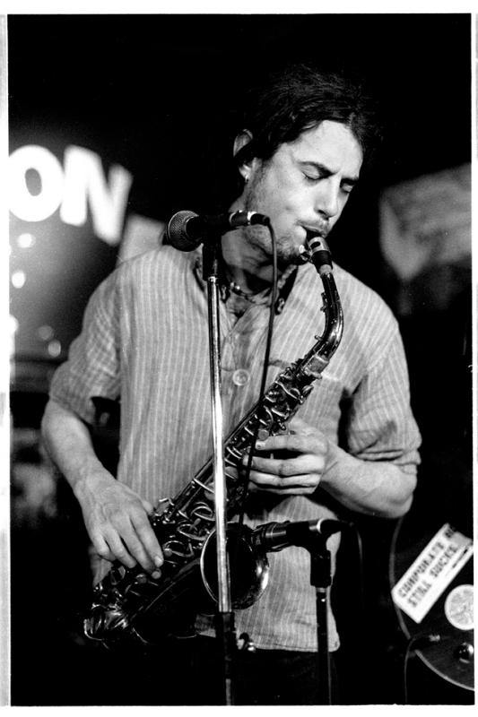

Last winter I was shooting black and white at high speeds. I found 1600 acceptable, 3200 was where I stopped as the latitude started to suffer quite a bit. Grain is certainly noticeable at 1600 and higher but personally I didn't find it objectionable. I stand processed the films in Rodinal, some of the results are below.
Tri-X 1600
HP5+ 1600
HP5+ 3200
Tri-X 3200

colpepper, to be honest you won't see heavy grain with web-sized images. So here is a 100% crop of an iso 3200 image to see the grain (don't like the image, is more for demonstration).
100% crops

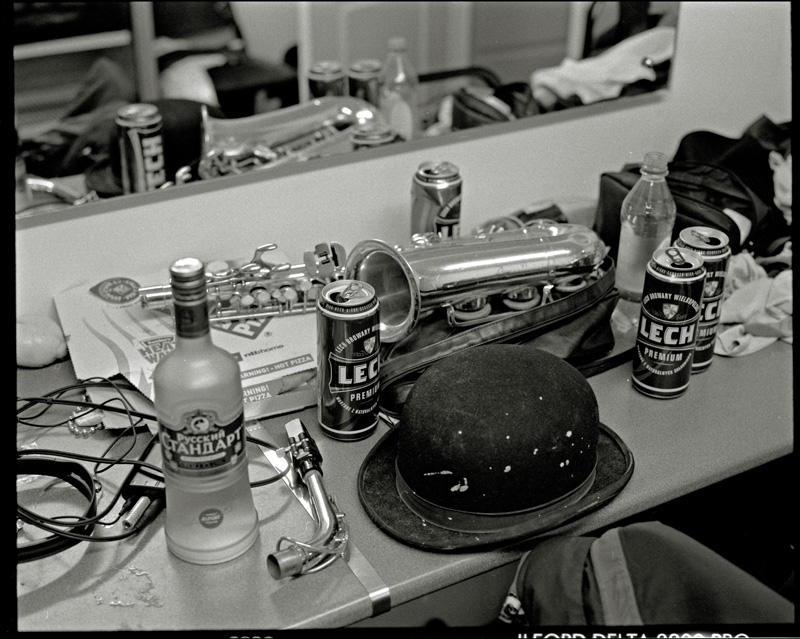

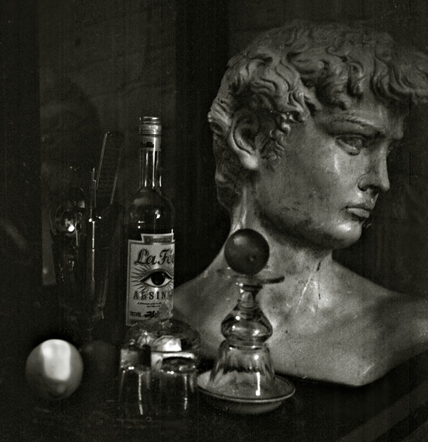

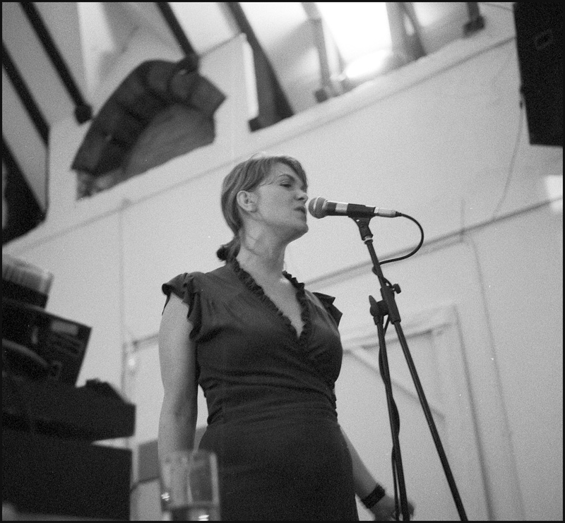

I've pushed many films up to 25,000 Ei and processed in Rodinal.
I use 120 but here goes Delta 3200 @ 6400 in Rodinal
Then Delta 3200 at 12,500
See the light coming in the rooflight– moonlight!
Delta @ 25,00 in Rodinal.

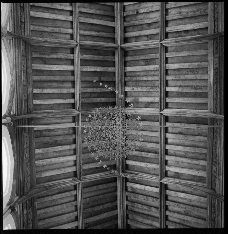

And a 35mm one TMZ at 3200:
Last one Acros at 12,500 stand developed in Rodinal:
A bit thin but work in progress
