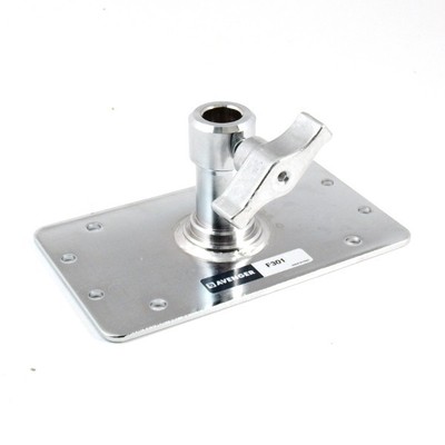

Not sure if these have a proper name but looking for a plate (steel?) with a standard threaded base connection to fit the top of a light stand so I can place a perspex sheet on top for a few product type shots.
Can anybody recommend one and a source?
Thanks
Hi Derek - what you need is a "baby plate":
These do not screw onto a light mounting spigot though: you take the spigot out of the top of the light stand and insert the rod on the plate in there instead. You can then place a small piece of acrylic (Perspex) on top, or you can screw the plate to a piece of MDF loft board (which I then painted matt black). This will support larger pieces of acrylic slab. I have one with a board, and one without, as sometimes, you need to get a light or diffusion panel really close to the bottle to get the light all the way to the base (and you can make the background as large as you want later on in post).

These ones with a ball joint are a little more expensive, but add the ability to level (or tilt) the table

Incidentally: "baby" refers to the size of the pin, and is the standard size for almost all flash heads. The next size up is "junior". The connection into the base on C-stand upright shafts are usually junior. These plates were originally designed to make permanent, static light mounting points on walls/ceilings etc.
OK, so the cheap stands I have won't release the spigot. There is a small locking screw that is easily removed but the spigot won't budge. Is it a case of more brute force required or do I buy a different stand to use for this?
A better stand or a double female spigot.
Whichever suits your kit needs best.
Like this?
I don't mind spending a bit more for a newcstand. Any recommendations?
These are good for regular stands:-
(they have the removable spigot ends on them that you can not only remove, but put in horizontally - which becomes useful later when you buy a bucket of Superclamps).
You can get female baby plates like this one:-
Tbh though, the stands with fixed spigots are usually lightweight travel stands, and probably not up to supporting a table/bottle. Best to get some beefier stands.
