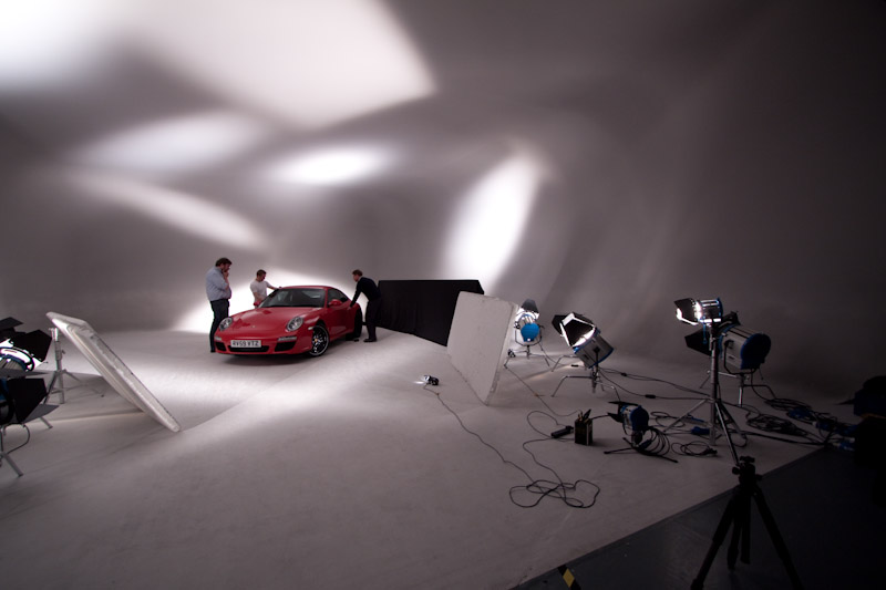

Well, you can reflect lights to soften them, but it takes an hour or so to get it right
That is a nice little studio, and an object lesson in lighting the the surrounding surfaces not the object directly. Not a single light is pointing directly at the car.
This goes equally for shooting a gold ring on a table set up, as it does for a car.
