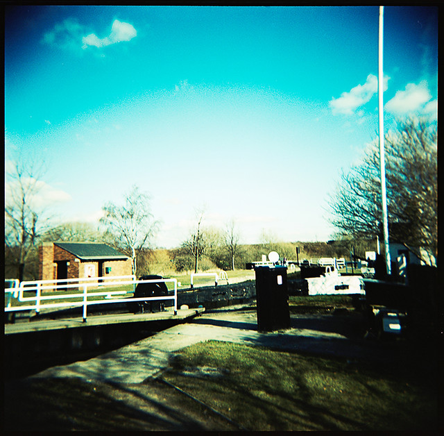

Provia 100 in Tetenal C-41 (shot on Helga the Homeless Holga)
Altofts Canal by The Big Yin, on Flickr
(if you click through to my flickr, there's a few other examples - they're all pretty gash, so I'll not inflict them directly on everyone ;))

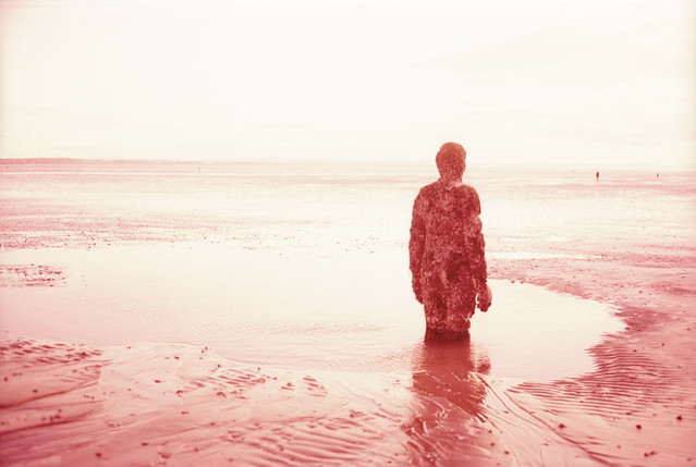

Fuji Sensia 200 in C-41
I bought a 1l kit and used half as normal then retired it as TBY suggests. Mainly because X-Pro film can royally b****r your chemicals
