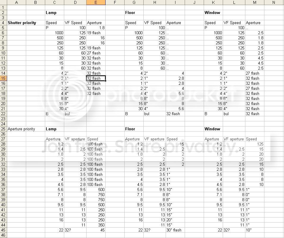

When selecting an aperture or shutter speed the majority of the time the viewfinder shows a completely different value from the one selected. I made this extremely boring Excel table to show which dial value corresponds with which value on the viewfinder. (400 ISO film. Tested whilst pointing at 3 different light conditions to check it was happening all the time, hence lamp/window/floor. The '..'s are shown in the viewfinder as the lower half of an 8 (like this one). If number is followed by 'flash' they were flashing in viewfinder to indicate incorrect exposure. I think for P the viewfinder value was 1000th (had half of the one missing) rather than 100th)
For both aperture and shutter priority they seem to follow the same pattern - ABBA CDDC EFFE GHHG. Metering seems OK (but obviously limited by not being able to access all speeds/apertures)
The problem extends to using the camera in manual mode too... set lens (50mm 1.8) to desired aperture and choose a shutter speed, the M symbol shows in VF, shutter remains constant yet aperture changes depending on light as if it was in shutter priority mode.
