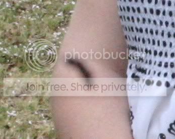

Ok. Here is one of the shots where the little b****r appeared, and the second is the same shot blown up. Does this help, or would more shots be helpful?
That is a spec of dirt on the sensor. It gets into the camera usually when you change lenses and when the mirror flips up and down it is blown around and eventually ends up on the sensor. What you are seeing is the shadow it casts, which is usually only visible at high f/numbers.
Set the camera to sensor cleaning mode (see handbook) and get a blower to it. Don't touch the sensor except with a special sensor cleaning kit. The spec is probably too small to see easily.

One thing that strikes me about that sample image is that it was shot at f/25. (Look how sharp that structure in the background is!!!) Sensor contamination shows up much more effectively at small apertures. If he tested each of his lenses systematically at a range of apertures, he might have found the problem on more lenses.
