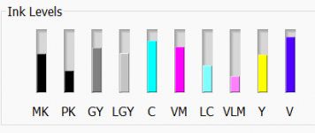

How many say A3+ colour prints would I get from that?
It depends...
If all you're printing is black & white, you're only going to be using the monochrome inks. Because there are so many colours, each one gets used at a different rate depending on what you're printing, and one cart is generally all you need at any one time. As I keep a full set, I never run out, and as soon as I replace one, I re-order it. I bit the bullet and bought a whole extra set when I got my P900. Elliot is right in that quite a bit gets used up.
This post I did on my experience with the P900 shows that you have about 1/4 tank left in each colour when it finishes charging. A subsequent post further down the page shows that I got about 40-50 A4 test prints out of that last 1/4 tank before needing to replace the LGY (light grey). If you assume say 3 A4s to an A3+ that would be around 13-15 prints per 1/4 tank before needing to replace at least 1 cart. You can go a good 3-5 prints beyond where Epson start warning you about empty carts too. By my very very rough maths, that's around 50 - 60 A3+ prints on a full tank before needing to replace at least one. Bear in mind though that my printing could be very different to yours. If you're printing predominantly "white lily on a black background" or "bird against a blue sky" you're going to hoover through those colours much quicker.
This is how my ink levels look now after 3 years of printing and you can see that the colours are all used unevenly... After the initial 6 months, I was probably buying 1 cart a month and I print quite a bit. Mostly A4 for test prints before doing A3+ or A2 for that "big print" feel.
Looking at my historic orders...
I replaced Violet last month. Light Gray (LGY) and Photo Black (PK) were replaced in April.
Vivid Magenta (VM) and Cyan (C) were replaced in Jan 2023
Light Grey is by far the one that needs replacing most often, but I do a fair bit of black & white printing. Blues get used much less often.
I won't get into the discussion on whether OEM inks are better than 3rd party ones. All I'll say is that in the first month of ownership, I caught my hip on the paper tray and broke it off. Epson sent an engineer out free of charge to fix it. It was an excellent service but the first question they asked was "do you use OEM inks?" For me, I'd rather have the peace of mind of print quality, warranty & repair than saving a few quid on 3rd party inks. But I'm fully aware others disagree. Maybe do the first 6 months on OEM, then consider 3rd party for peace of mind?
