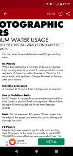

My small darkroom doesn't have running water and I'd prefer not to connect it to the house with a 30 metre hosepipe.
I'm going to be wet printing onto Ilford MG paper. Part of the Ilford Technical Information "Washing Photographic Film & Papers" states an alternative method for RC papers:
It is also possible to use a sequence of three trays with still water in. Wash for 15 seconds in each, with agitation. Change the water in the trays after each session.
Does anyone one have direct experience of this method? Does it work etc?
