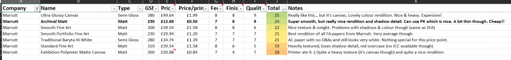

Marrutt papers are adequate at best. Archival Matt being their "most" adequate paper. My top 4 matt papers would be St Cuthbert's Mill "Somerset Photo Satin", Permajet's "Photo Art Silk", Fotospeed's "Platinum Etching" and Hahnemule's "German Etching". If cost is a concern, the Fotospeed paper is really good value for money (IMO of course!), but if you put a gun to my head, the Somerset paper would win out*.
*This is based on my experience, of my images on my printer, with my ICC profiles, and my preferences of image quality/coloour balance. Your mileage may very well vary!!
Additional reply to note I haven't tested any Oyster papers from Marrutt. Perhaps their range has changed?
