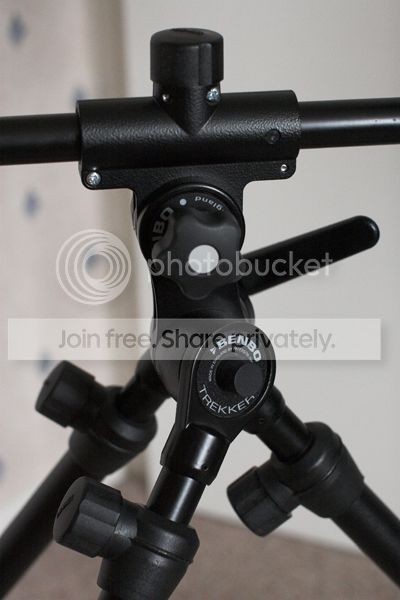

I'm not a great lover of tripods but for the limited times I use one I want it to do what I want and after years of frustration I'll never consider another conventional centre column straight up and down through the middle of the legs design. I'll only ever consider something as flexible as the Benbo I have now...
http://www.patersonphotographic.com/benbo-tripods.htm
If you go for one of these get the additional centre column bracket for extra control and no drunken bagpipes effect.

What bracket is this? I don't see it on Paterson's site...
It allows independent movement of the "column"...
If it's not on the site maybe give them a call.
