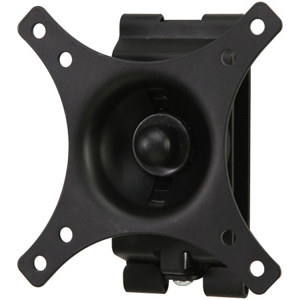

did one for a mate a few years ago, i used the vesa plate with the hollowed out curve underneath so you can fit a nut underneath to bolt the ballhead down
you need one like this
or this
Its actually a Vesa adapter plate you need as they come in different sizes, 100x100, 200x200, 400x400, the larger the plate the more stable the platform
its only the plate you need and it needs the hollow/raised area underneath, the plate should be pre drilled then all you do is bolt it from underneath with a standard 1/4 or 3/8th bold to secure it, thats its it really.

Nice - I like that idea Gary. Would you just bolt on a ball head? Would be good with adjustable height <thinking>

And thats the beauty of Vesa plates, they are pre drilled so if using on grass and for more stability just use steel tent pugs to secure it.
