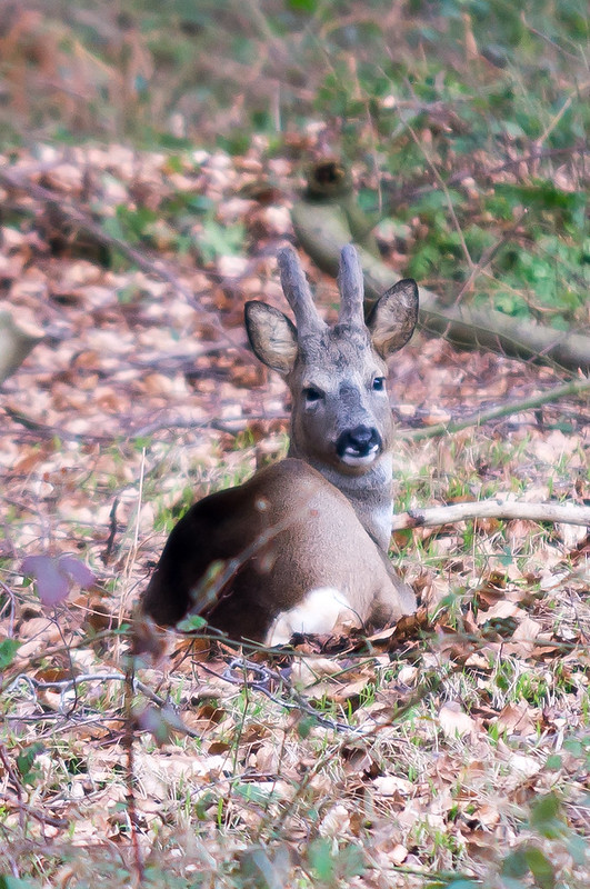

I looked at some of my images and its clear that the problems are due to cropping, I guess I was hoping that having more pixels would improve the quality of my crops, but theres no escaping from the fact I need a bigger zoom. Here's a photo I posted in another thread that is not cropped that much from the original image:
DSC01318 by tomsouthall, on Flickr
This was taken at F3.2 1/500 sec and ISO400. There is something just not quite right with it, many parts of the scene seem grainy to me and this has had some sharpening and noise reduction in LR4, let me know your views..

All aspects of image quality take a hit when you crop. For more reach, rule of thumb is get a longer lens, then add an extender, then crop as a last option.
It's not an absolute rule by any means but works as a general guide as to which corner of the envelope to push first. And they're all pushing one way or another, long lens wildlife stuff is not easy.

Ok yes - that's past salvageable lol. Longer lens :)
I haven't used the camera myself but people make too much fuss over noise. Use a decent lens that is stupidly sharp and the detail will be retained up to whatever ISO you use. The rest is in your PP skills but you can (noisewise) clean it up to look like something shot much lower (I had a thread that showed a 25600 image cleaned up to look very similar to a ISO 1600 shot).
There is some strange artefacts going on there though - it looks like a water painting filter has been applied or something...all you did was crop??? Any sharpening, if so what was the threshold?
The image has been over cropped, over sharpened and then over noise reduced. Get a longer lens. If you still have a problem then a new camera body may be in order.
I know its bad, you don't need to re post it!! I was just using it as an example!
quite a bit...! and some heavy front focus icing on top
Another thing I've noticed is that when using large apertures, anything that gets in the way of the target (ie. branches) look terrible and completely ruins the shot. There's no crazy effects on that, but sharpening is at 80 (radius 1.3), I guess that is kind of high!

25-40 at r=1.0-1.2 is a more reasonable sharpening range. NR definitely less than 20 or indeed a set of water paint is a better tool.
