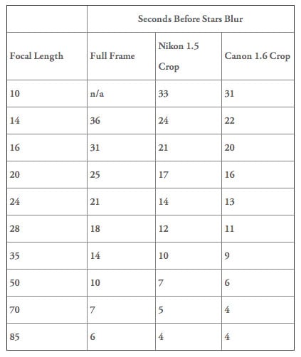

You need to turn the auto focus off and manually focus onto something in the foreground, then set the camera to manual. If you are wanting to avoid star trails, your shutter speed is determined by focal length, I'll put a chart up below. Aperture is wide open, f3.5 with the lens you have. Now all that's left to set is ISO, this is light sensitivity.
Because the shutter speed is determined by focal length and aperture is set to wide open, ISO is the only setting you need to alter. I would start at a round ISO 2500 and see what you get, higher the ISO more stars will be visible.
Its all trial and error when you start, but the beauty of digital is its free, it doesn't matter how many times you get it wrong ;)......just enjoy the learning :)
Here's a chart for shutter speed compared to focal length, I would go with 18mm and a shutter speed of 16 seconds, that gives you a second or 2 to be on the safe side to avoid star trails.

Edit to add, the 500 rule applies to full frame, on a crop body it becomes approx. the 350 rule ;)
