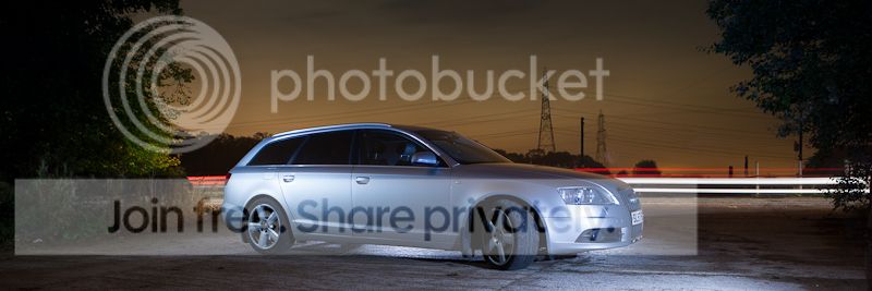

Here's one I did when messing around.
Can't remember the exact settings, definitely 30 seconds @ f/4.5 or 5.0ish. Stuck the camera on a 10 sec delay and legged it round the car with a flash set to 1/16 bursts and gave it three or four blasts from different angles and a couple more from underneath.
Put a blue grad on the sky in LR to take out the streetlight orangeyness.
Could probably be better but like I say, it was just a quick mess about.
I've thought about doing this, I do have an SB-600, would you say that you get better results using a flash, or running round the car with a torch?
You did well for timing to get a car light trail in the background too
