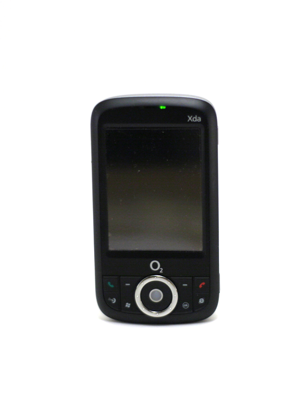

not jewelery but one I did recently one a white board - one brolly and a reflector
is that the kind of effect you're after?
