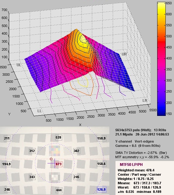

My 70-200mm hasn’t been the sharpest and after some side by side tests against a friends it is noticeably soft particularly for further away subjects. It’s definitely the lens and not technique
I’ve read that optical adjustment is a precision art and requires specialist equipment and knowledge. Has anybody used repair agents, or would Canon be my best bet. Any idea of rough cost?
I read this interesting article, although a bit old now.

If you look elsewhere on Roger Cicala’s site at the kind of equipment he’s got you will definitely give up any idea of a diy solution :). He has better kit than many manufacturers.

I wish it was - as that would be easier to sort. Unfortunately it's just soft :-(. I'm suspecting a decentred front element or something. Wish I'd noticed it when I purchased it.
