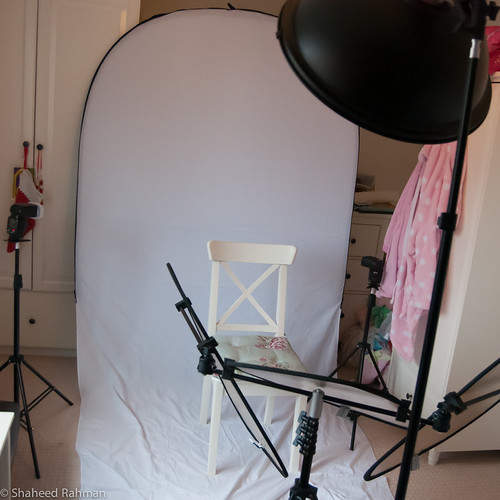

Hi
Thanks for looking!
In those shots I used a triflector and a beauty dish. I had a white backdrop (I used to use a pop up one but had some vinyl on this particular shot)
The set up is similar to below, just without the strobes on the background.

Hope that helps

ahh the thought of a popup backdrop never occurred to me. any recommendations? im after something cheap and was tempted to buy a cheapo backdrop on a frame off ebay.

I think I just started with the photosel black/white one from amazon. Although I have a double sided vinyl backdrop and stand, I still use the pop up occasionally as its quick and easy to put up/take down.

ah ok cool. do you recommend the backdrop? on amazon some people give it a mixed review. saying the white isnt too white, more of a grey. also i dont suppose you know anywhere apart from amazon/ebay i can get one used?

I thought it was fine bit if you want a proper white background you'll invariably have to light it separately.
I used the black side quite a lot too.

The 'white isnt too white' is probably down to them not understanding it needs lighting, bear in mind too, you can make any amount of grey white with enough light;)
