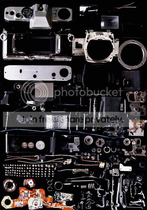

This image is of the dead one before you all come round my house with pitch forks lol i love my cameras and treat them with the respect they deserve. I was surprised to see that the top plate is actually plastic!
Hey, that's a great pic Simon!
