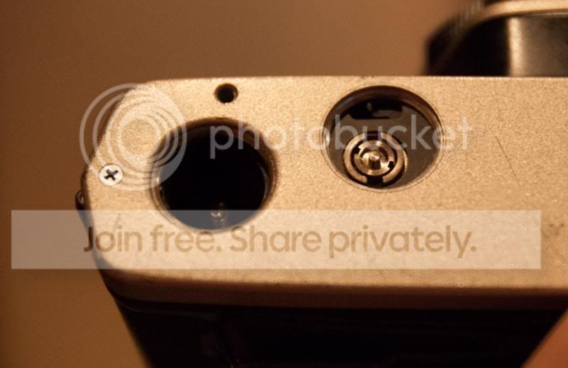

I've recently picked up an Olympus OM4ti along with a few accessories. There were a couple of issues when I inspected it, firstly the previous owner had managed to superglue the back closed while trying to restick the leatherette.. That's now released and everything on that front is fine..
When I was looking through the viewfinder - the 'display' at the bottom of the screen was blueish from memory.. Then the batteries gave up.
Today I have fresh batteries and now the display appears to be more yellowy brown.
Does the colour change depending on lighting conditions? I couldn't see a mention of it in the manual?
That's the easy things out of the way - now for the tricky..
I know the camera has a 'manual' no battery use mode for B and 1/60th of a second.
In the no battery 1/60th of a second mode, the camera operates normally - and can even be fired by the winder, which the instructions say it can't.
Press the button - up goes the mirror, down goes the mirror, wind on. Perfect.
Now when I take the camera back into 'Normal' operation mode, Auto or Manual - doesn't matter what shutter speed or aperture, I wind on, activate the shutter, the mirror goes up, and stays there.
The only way I can get it to drop, is by pressing the lock button, and sliding the shutter speed ring back to the manual 1/60th setting.

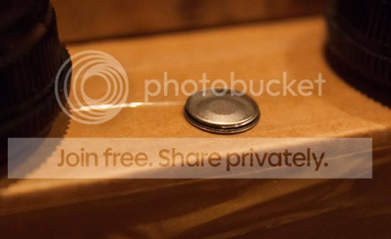

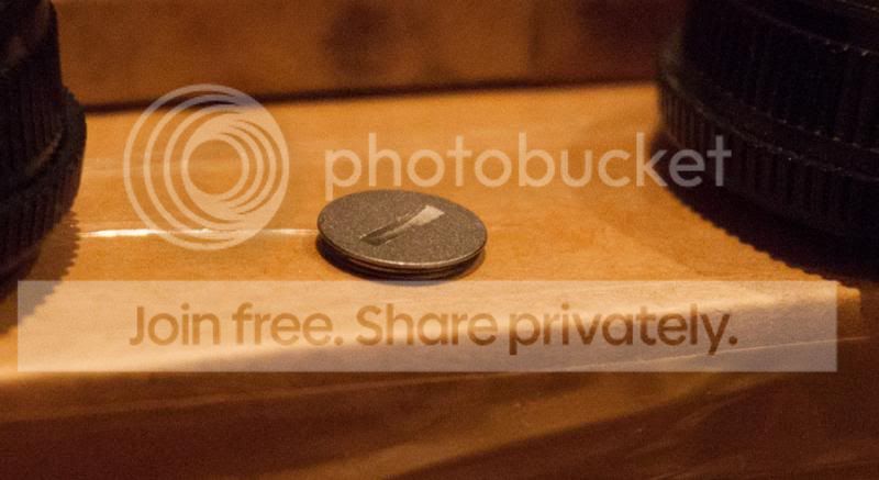

The batteries are new this evening. I've checked the manual. I've searched online. Am I supposed to do anything when new batteries are inserted? Any kind of reset?
Has anyone come across a similar issue?
I find it unsual that in 'non-battery mechanical mode' it operated normally - but in normal mode with fresh batteries the mirror sticks up on every exposure... They are SR44 batteries by the way not LR44 batteries - as I believe this can also make a difference...
Any ideas from the technical wizzes? Thanks
