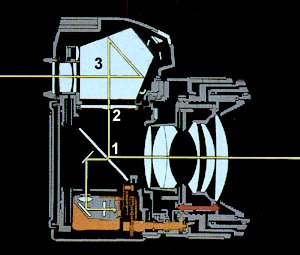

As people here have said, you must look for and check every part involved in what you see when you look through the viewfinder:
Part number 1 in the above picture: "The mirror", remove the lens of the camera and check if the mirror is locked up and blocking the light.
Part number 2: "The focusing screen": if the mirror (1) is down you will see the focusing screen, check if its clean, you can remove it, here you can find how to do it:
http://www.mir.SPAM/rb/photography/...ympusom1n2/shared/accessory/screens/index.htm
Part numer 3: "The pentaprism": if you remove the focusing screen (2) you will see the the lower face of the pentaprism, check if its clean.
Here a section image of the OM-1: http://www.photoxels.com/images/Olympus/om/olympus-om1-xsection.jpg
