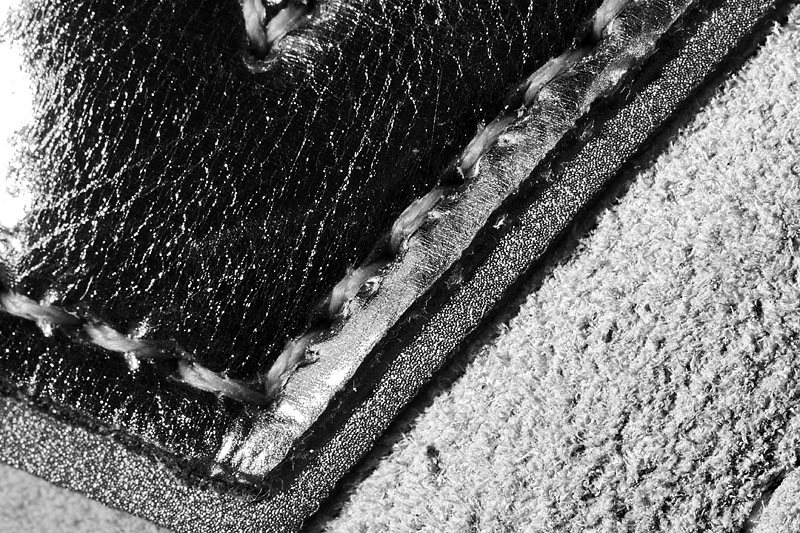

And here's some cross-lighting on the side of a shoe:
