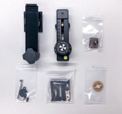

The advantage of proper kit like the Nodal Ninja range is that not only does it hold the camera Inthe correct portrait orientation , but you can also do 360x180 pans and multi row pans.
They can also have the no parralax point set semi permently for quick setup.
They also have click stop rotators, so you get the correct overlap.
For landscape pans, you can mostly do them hand held, with no extra equipment at all. Though close objects can cause parralax problems.
Probably the best bracket on the market for medium sized mirror less cameras with normal sized
lenses, is the Nodal Ninja 3 mark 3.
I have one of these, not as good as the latest but works brilliantly
