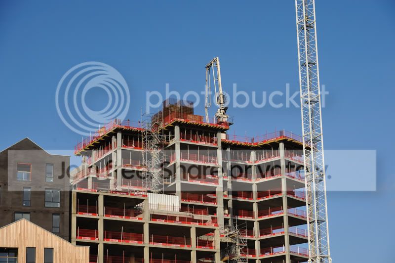

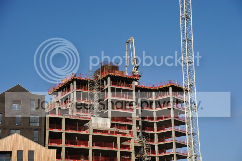

Despite the annoyances there are some very good functions. The feature that I like on the latest version is the automatic correction for lens distortion. It recognises the lens type and makes pincushion/barrel lens distortion corrections.
Picture taken using Nikon 24-85 f2.8-4.
Correction Off
Correction Automatic
Note the straightening of the crane on the right.
