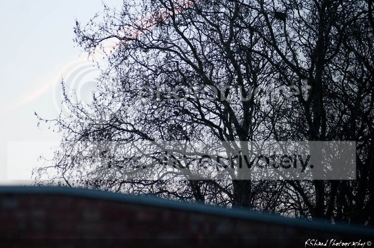

80-200 no filter:

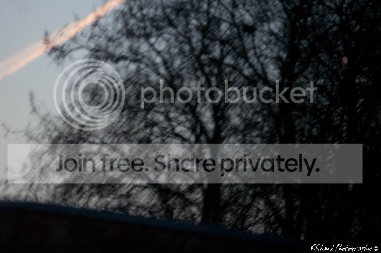

80-200 CPL:

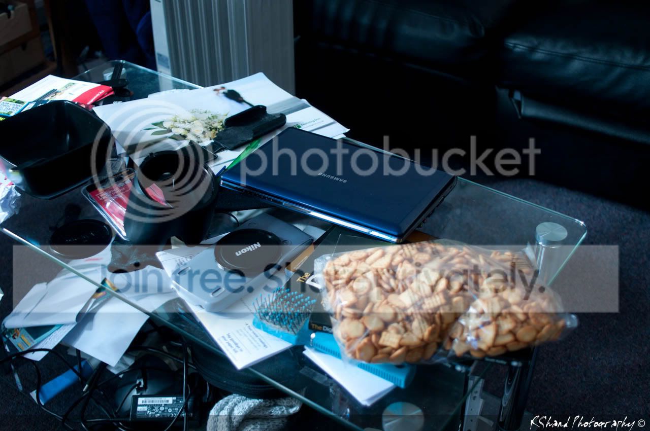

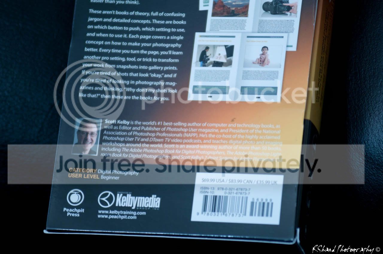

28-70 no filter:

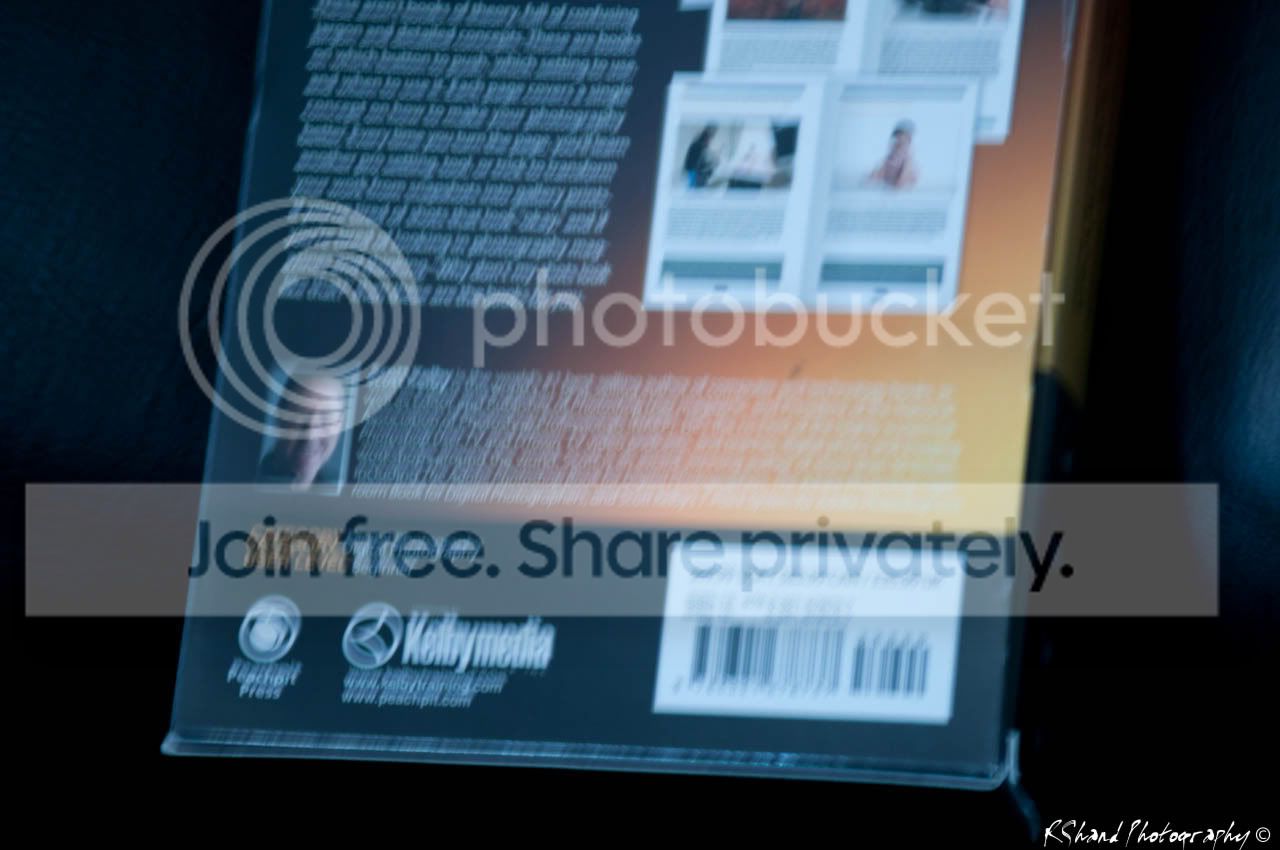

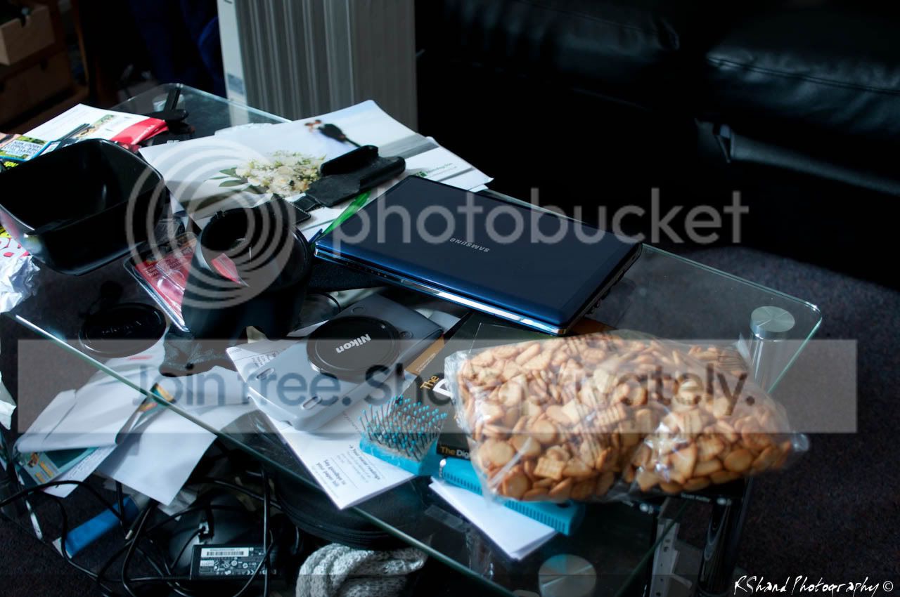

28-70 CPL:

the 2nd shot looks for all the world like shake to me... perhaps from the pressing the shutter release?
Normally I'd agree but I was using a wireless release, even though I did do it again thinking the same. The above problem was replicable every single time. Filter off nice and sharp, filter on what appears like shake.

First shot is .5 second , second shot is 1 second . Is it a vr lens & did you turn off vr ?
I wish this lens had VR! Nope, no VR on this or my other lenses
Have you tried a faster shutter to rule out camera shake ? looks like that to me :thinking:
Try with mirror lockup enabled, the shutter and mirror can introduce quite a lot of shake with a long lens
A polariser cuts 1-2 stops of light. All that's happening is with the filter, the exposure is slower. Hence shake. Could be as you move away, the floor is moving the tripod. Its definitely shake. Put it in shutter priority and choose a fast speed and try again.

The second shot is surely camera shake, especially given that in the fourth shot it's nowhere near as blurry despite having the filter on.
As the others have said, it's shake or movement without a doubt. I know, my library is full of such examples.
It's quite clear to me in the second photo that the view moved down and to the left (or up and to the right) during the exposure.
