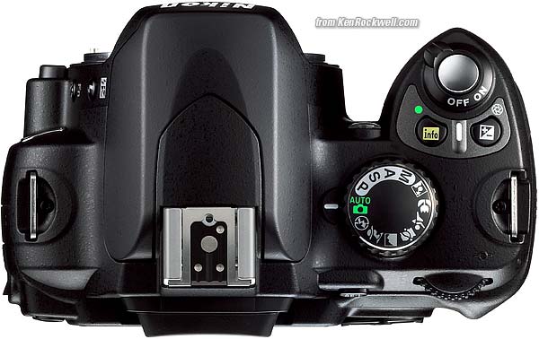

Some of the D80's have issues with Overexposure.. it's a little camera quirk ;)
On mine I dial in -0.7 on the exposure compensation, most of the time when I'm outside, then correct as needed :)
Thats not the right camera, but the button you want is the square one with + and - in the square box :).

Matty i did adjust that button, but it only marginally improved things, but cheers for the suggestion. I'm very much learning with the camera so i am likely to miss these options:D
