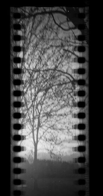

While I'm waiting for my Mamiya to arrive I started looking at my old Ensign Selfix again. Rather than use a roll of 120 and risk wasting it (the lens mounted viewfinder/focussing are pretty inaccurate!) I've decided to use it for some panoramic 35mm fun.
It's a 6x9 120 camera so I first used a developed roll of 35mm and taped the end to the 120 spool and wound it on to see how many turns it needs to cover the 6x9 frame. Turns out it's around 2.5 full turns of the wind on reel. After that, I then made up a paper leader and taped that to the leader on my 35mm Agfa Vista so I can wind it in to place with the back closed. There are also card tubes above and below the film to keep it central in the frame.
To make matters harder, I've already shot 4 pictures on the roll of 35mm in my EOS30 before winding it back to take it out of the camera so I've needed to (roughly!) factor that in!
I'll upload what, if any, results I get :0). This is probably my favourite shot from this camera with 120 film
