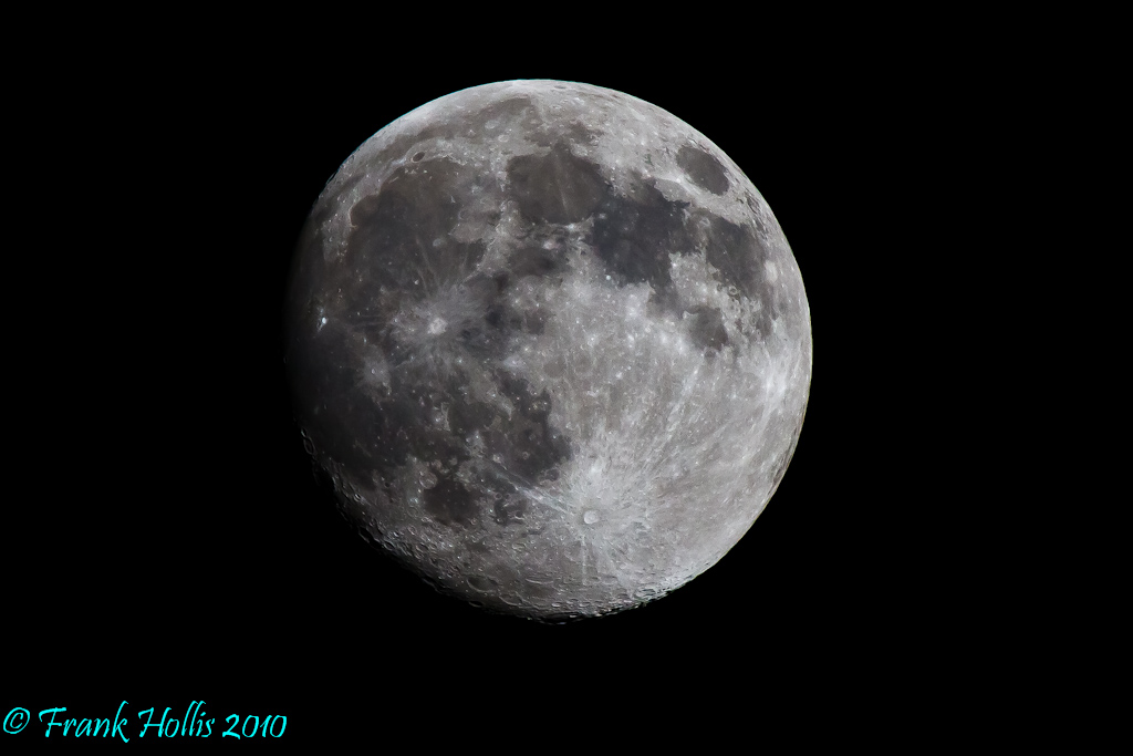

Yup, you can't beat having a long lens. This was shot at 600mm (300 f2.8 with 2xTC), ISO800, 1/1000s at f8.

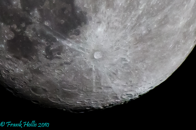

And here's what a 100% crop looks like.
Using ISO800 means that you can get a fast enough shutter speed to negate the need for an ultra-stable tripod, remote releases and mirror-lockup.

I hadn't realised that you needed a faster shutter. I attempted at t/100, and was quite dissapointed.
I think the phrase about not being able to hit a barn door comes to mind.
Thanks Frank, some good tips there. I have been using my lowest ISO and about f16 ish but using longer shutters. Will bump the ISO up to 800 and then open the apature next time.
Still need the lens (or a TC) to avoid monster crops however.
