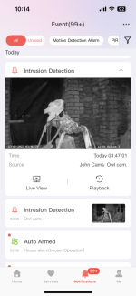

I've fitted a few cameras in a few places that might be considered less straightforward - like this one at the top of a church tower for owl watching (Although he's not there quite so frequently at the moment) - livestream here:
https://rtsp.me/embed/tRn3b7Ei/
If you want something really reliable - you do need power - but you don't necessarily need mains at the box.
Would there be a possibility of running a single Cat5/6 network cable from the house to the box? (Assuming you want one single camera) You can get it on reels (outdoor weatherproof - usually black).
There's a couple of straightforward tools needed for crimping a network connector onto either end that can be had for around £25 total.
You then need a POE network switch in the house plugged into your existing router - these are fairly cheap - around £20ish for something that'd be suitable from someone like TP-Link.
POE is Power Over Ethernet - so what that does is it sends power down the network cable from the POE network switch that you'd plug into it down to the box - and you'd then buy a POE camera for that other end.
You then have the choice of which POE camera you use - there are several micro-birdbox style cameras - or you could even use a regular CCTV camera if the box is big enough.
Another option of course would be to have a POE Network video recorder which can be had for around £100 ish that could be used instead of the above mentioned POE network switch - the camera could plug directly in - and you'd then have the benefit of recording whatever is going on in the box as well. (Potentially with motion alerts so you know when you've had visitors). At a later date you could also plug in a couple of cameras for your own home security if you thought it worthwhile.
Doing it this way would do away with the need for wifi. That's a starting suggestion to see if you think that might be doable.
Another benefit to using a CCTV network video recorder and a regular CCTV camera would be that you could set up alerts for when there's any activity in your box - and with it recording - when things happen at daft o'clock in the morning (In the case of this morning - 03:47am), you can go back and watch what happened. (The camera here auto-zooms when it detects activity in a certain spot)
