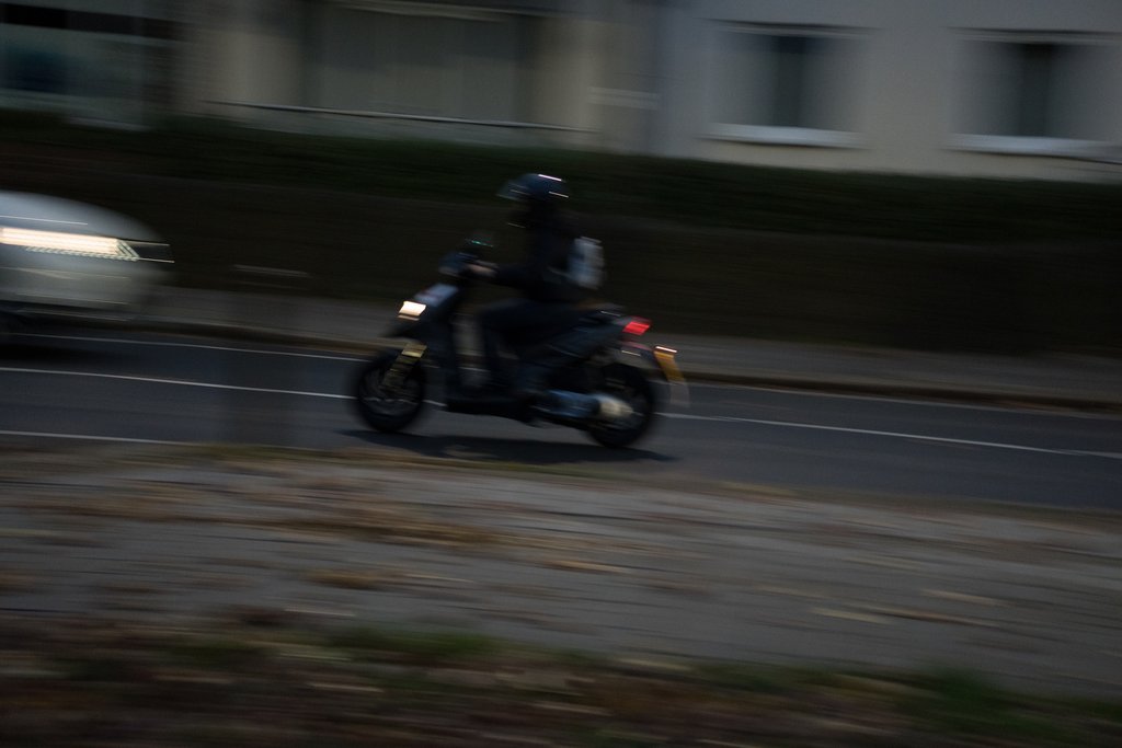

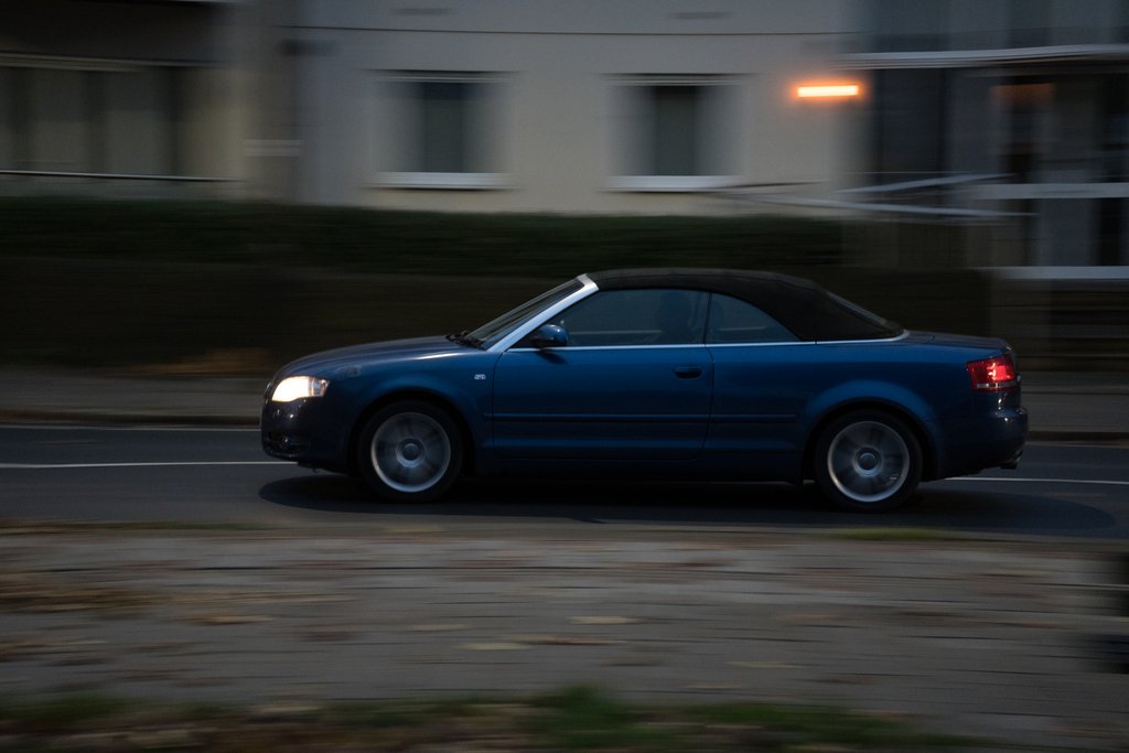

This blue car was my best effort. Most of the rest of my shots before and after were like the motorbike. :facepalm:
These were done in low light which the a6600 isn't very good at. So it was ISO 2000, 70mm, f4.5 and 1/30th.
