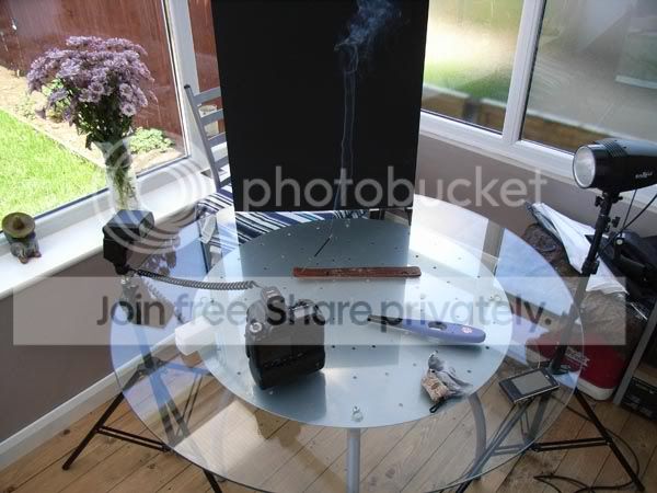

1. The gear.
I set up in conservatory as it had easy ventilation, which you will need later.
I used my sigma flash gun on a hot...

I've tried this today but I couldn't get the flash right... I kept getting light falling onto the black background which is a problem, but i'll keep on trying!! I've only had my D60 a week :)
You are using an off camera flash unit??? If you are and it is still falling onto the background The you need to angle the flash more towards the camera, if that still fails try using a peice of black card taped to the flash to act as a snoot and direct the light away from the background.

I'm using an SB-600 flash unit... I'll try the card around the flash....

What distances are you placing the flash from the back ground??
Ideally it needs to be about 1ft off to the side of the background and about 4-6 inches in front of with a very slight angle towards the camera, say no more than about 20-35 degrees. Don't use a stoffen or similar diffuser, just the raw hard light from the flash.

The light on the right of the set up is one of my studio lights. I tried to use it first to see what difference it made by lighting the smoke from both sides. The answer. Not worth it.
