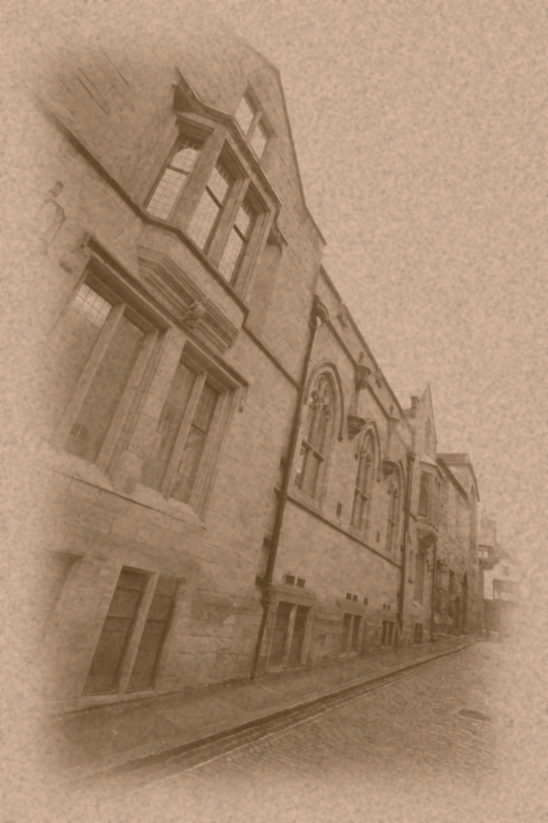

this is just a DSLR image , with a click on 'old photo' button in GIMP (free) image editor.

  • Composition - the example from tricky fails for me on several levels, the lens used is too sharp and the wrong focal length, but above all I have never seen a vintage image with such a dynamic composition. It just looks wrong from a distance

  • Grain - if you look at old prints with a magnifying glass (or at high scan resolutions) there's several distinct grain patterns. With albumen prints it's less like pattern of grain and more like a flattened texture. Tricky has got a grain texture that's actually pretty close to my eye for an albumen print, but the GIMP filter isn't applying it in the right mode, to me it looks like the right texture in the wrong place.
