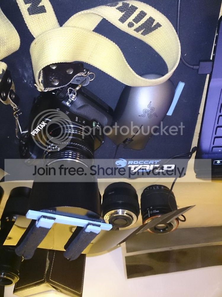

So I've spent pretty much all day building this and after the very first shot my cameras battery dies! DOH!
It's fully adjustable so should be able to work with any lens that will focus between 40 to 120mm infront of it, it attaches by a 49mm filter ring and the first lens I've tried to test with is a 35mm 2.8 Pentax-m
It will do a 120 pic in 6 shots and a 35 in 2
enough of the boring stuff onto the rig & results!
Here's my handiwork
I thought I was understanding this until this sentence! Could you explain, or show diagrams or something? Are you saying you stitch the shots together?
I also wondered what you do about the base colour problem for colour negatives?
Looks clever though (I guess it's the same principle as the "stand-alone" scanners we warn folks against, but with a much better camera involved, capable of taking raw images, which should help a lot!)
I can think of so many reasons not to do this but if it hasn't cost much time or money why not :)
