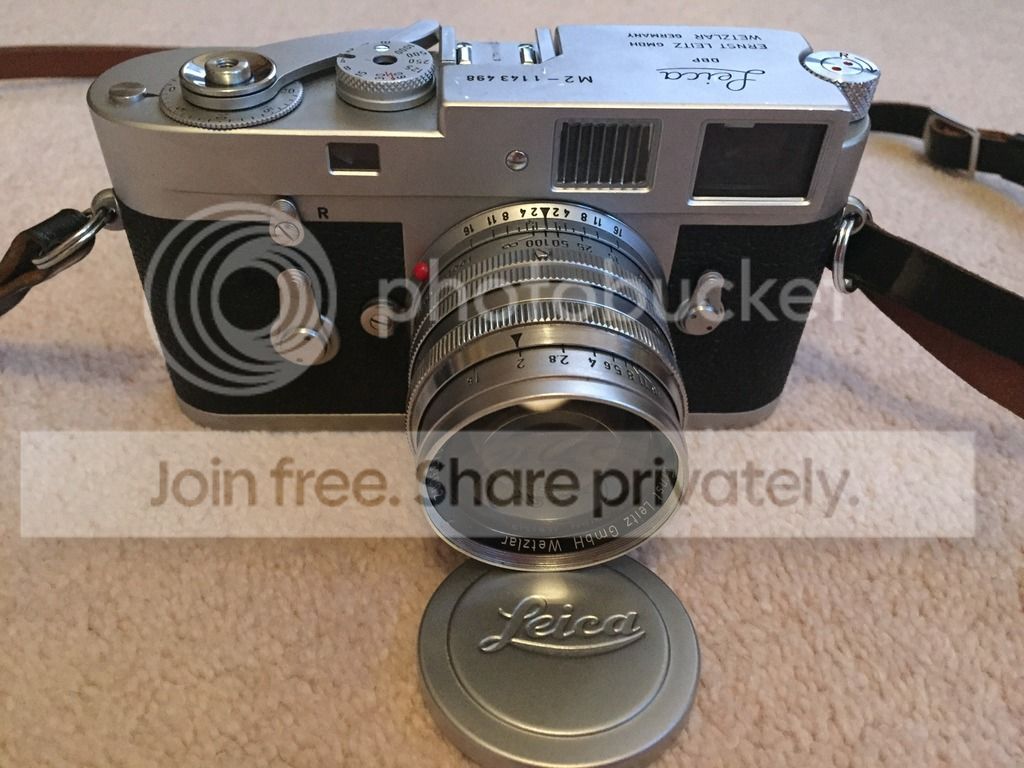

My new baby!
*DROOL*!!!!!!
Is it normal for the focus ring to feel very stiff?

How tight is the focus? It shouldn't be difficult to turn. If it's been sat unused for a while it may loosen up over the new few weeks. My Canon LTM feels quite a bit better after giving it a good workout for a week on holiday.

Could be just a big of use. Seemed stuck at first but now moves but needs firm use. Seemed to free up a little, so will keep playing with it. It is a 59yo lens but does seem an effort.
Sounds like old grease and years of tiny bits of muck that's hardened. It should free off a bit with use or (if it was a much cheaper lens) you could try dribbling a little lighter fluid down the barrel to help soften it up but that carries a risk of oil and grease getting out on to the lens elements or aperture blades. Best thing to do would be a service/CLA.
In a word NO,it should be silky smooth,if not you should get it looked at by some one who knows.
Will be sending it back to MW Classic - it was described as 'smooth focus'. Shame as its in excellent condition otherwise bit very hard to use.
