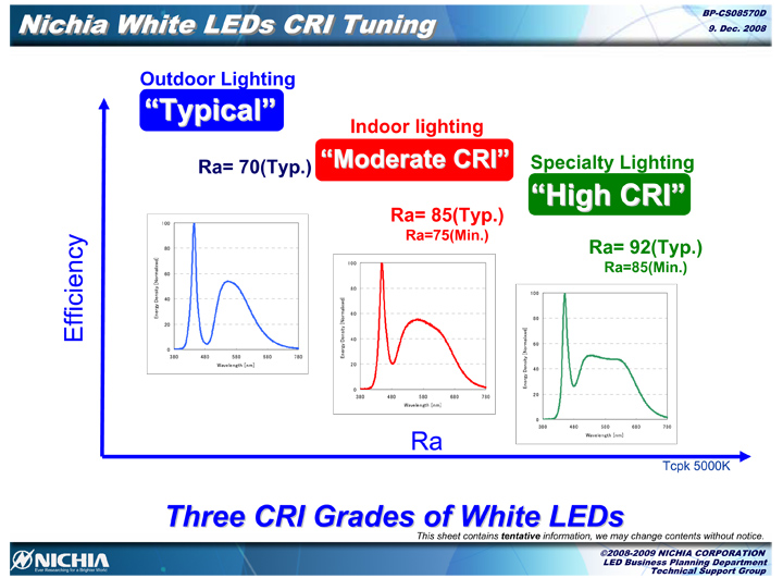

CRI = Color Rendition Index, it measures the spectrum emitted by the light to give you an idea of how many % of the color spectrum visible to the human eye they emit. Objects can't reflect light that's not there so a low-CRI light source will basically strip your photo of parts of the color spectrum.
The human eye is extremely good at compensating for lower CRI in real time. However when you take a photo in such light and show it to someone in a normal environment, the problem sticks out like a sore thumb.
Googling for 5050SMD I find leds with CRI at 60-70% (so missing out on 30-40% of color spectrum) and high CRI models which I guess are 85+%. The highest output ones are typically of lower CRI as it's a balancing act between efficiency and spectrum management.
As an example of very low CRI, Sodium and mercury street lamps have a CRI of <30% which is why they look almost like monochrome pictures with very little traces of washed out colors.
This is an example of the spectrums from Nichia which makes nice LEDs..
And before someone says "color temperature", well that's different :)
