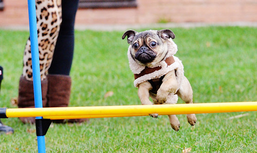

Thank you all! I read the tutorial that Steve provided and mimicking the settings shared there seemed to help. I managed to catch a few decently sharp moving subjects, like so:
DSC_2709 by thedogblog, on Flickr
Shall have a play with focus/release priority and rear button focusing tomorrow! I'll get there.
Looking at that leaping Pug, you're very close to there!
