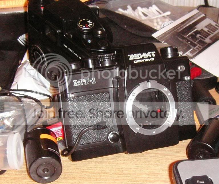

OK then, here's the MT-1 from Zenit, called the "Surprise" for some reason. Designated MT, the design is specifically for endoscopic photography and the camera is a half-frame 35mm slr derived from the Zenit 19 I believe. Anyway, it does not take standard lenses coming as it does with an odd three-way bayonet with a screw-tightening arrangement (Praktina?). If you can get one of these cameras for a decent price (currently up to £90 on the flea place but they can be had cheaper) then they are relatively easy to convert to M42. You just take off the bayonet fit section and replace it with an M42 section "borrowed" from an earlier Zenit model (or a Prinzflex 500E in my case), simples.
Mine had a dead mirror system which had to be replaced as well as a pentaprism that looked like it had gone rusty - but today saw the finishing touches and first fit of lenses along with focus tests. So far, so good - all seems to be square and in the right place. I suspect that because of the half frame format I am going to get some vignetting if I try to close the apertures below f/16 or so - but I can live with that and it is a great camera to get into a working condition. I suspect first off will see one of the cheap Chinese films being shot through, just to be on the safe side

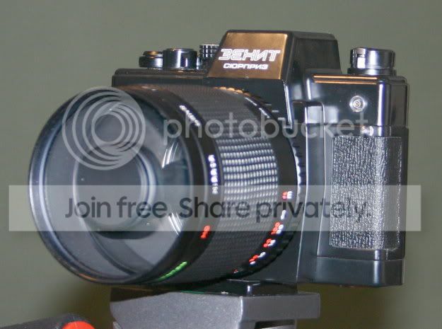

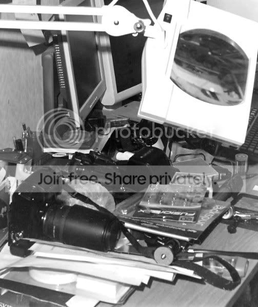

With 500mm mirror lens

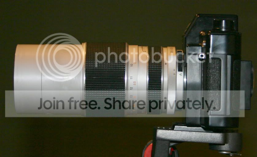

200mm tele

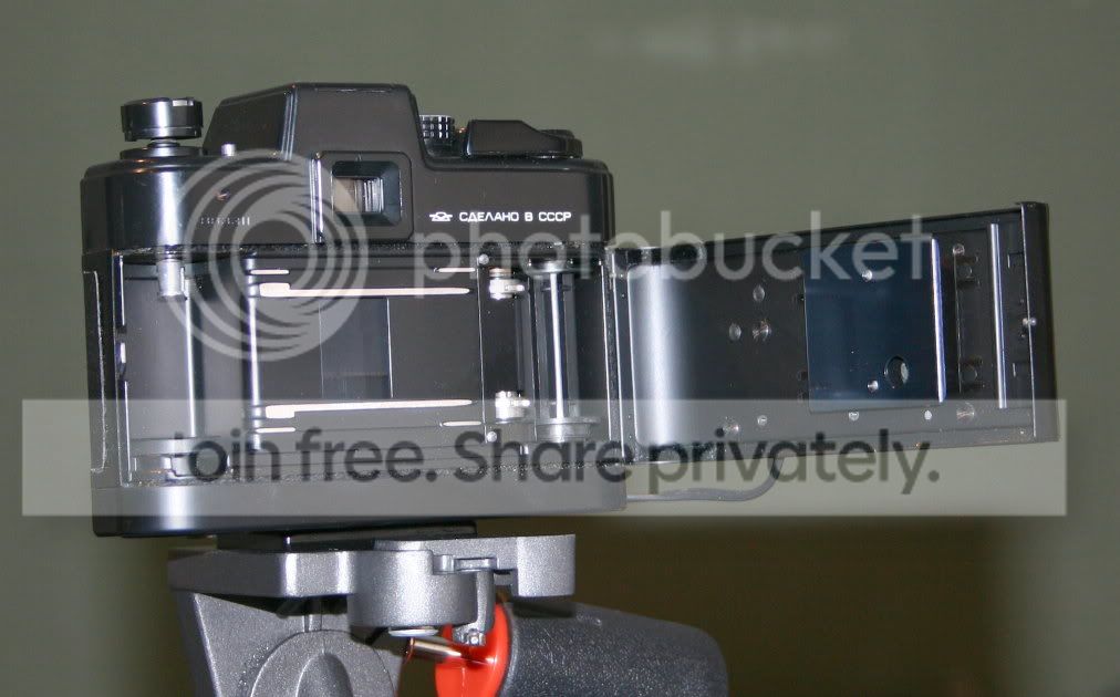

open back
