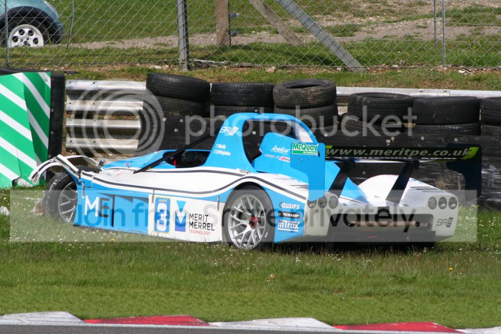

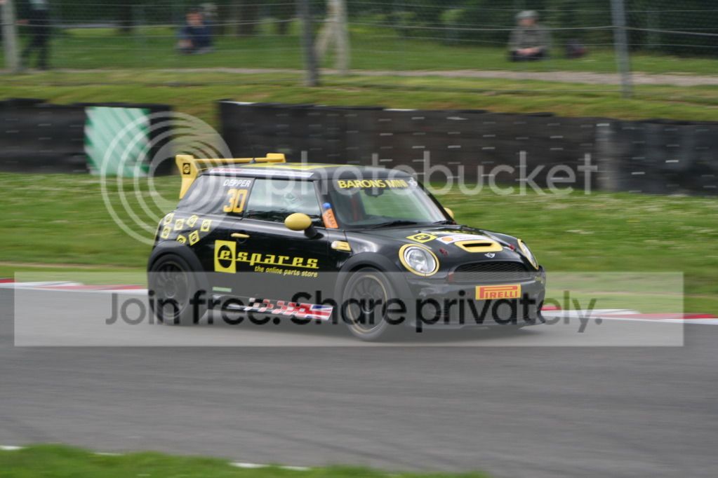

Wow, thank you so much all of you. I've been knocking around here for a while, took a few at Brands last year with a 350d and a Canon 70-300mm lens. I've now got a 600D and a Tamron 70-300mm lens. Took a couple of these ones last year, i dont know if it was the camera or me, but they didnt seem to be focused very well. I was also taking these hand held, but now i've got myself a mono pod as well. If anyone can see where i was going wrong let me know.

I wouldnt use a monopod personally as they restrict movement I find rather than help unless your using a massive lens like the the 300 prime etc.
Number ones through through the fence, thats why its soft as your camera hasnt focussed througg the fence.
Number two: youve either missed focus, to slow a shutter speed or when you pressed the shutter you stopped staright away rather than finish of the pan
Number three: Was it still moving when you took the shot or was stopped, the tyres look sharp. It might have been that you had all focus points selected rather than individual so the cameras focused on the trees.
