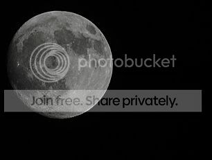

This one was taken with a 300mm lens set at 270mm, not sure why I wasn't at 300mm :thinking:
Apologies for the logo, it's straight from my flickr.
Moon by Nick Axtell Photography, on Flickr
It as shot at iso 200, 1/250th and f9, cropped in PSE.

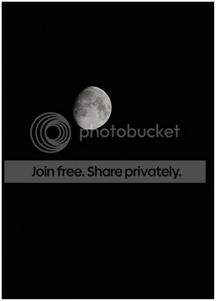

hey everyone, ive had a play around with it and this is my first shot of the moon hope you all like :D
the settings i used for this one is 1/100, iso 200 and f20
