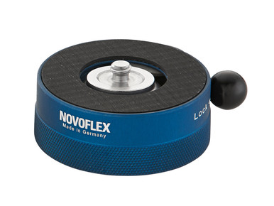

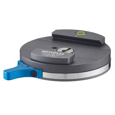

Although, people say there is no need for a ball head on. monopod, for "general" use I disagree and my main monopod heads are ether a the FLM 32
or
the Novoflex Magicball "Free"
For general use I find it the most stable approach is to make sure the monopod stays vertical and use the ball head to adjust vertical and horizontal tilt. But also, sometimes I feel it useful to "jam" the monopod at an odd angle and the ballhead lets me fully adjust the camera position.
For birding this doesn't work so well as a loose ball head (even one with adjustable friction), while following a flying bird tends to end up all over the place and is difficult to use. The Novoflex head is, for me, the best all round solution, good for general photography and good for birds.
At the moment the FLM lives on my general purpose monopod, and the Novoflex on my heavier birding monopod.
