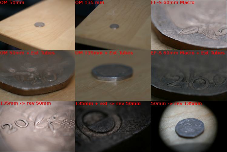

Quick Sample of the set up (this is the OM 135mm on full ext tubes and the you can nestle the OM 50mm inside the hood as the diameters match):
These are the various combinations taking a shot of a 20pence piece, straight out of camera not crops. I've included shots from my Ef-S 60mm macro for comparison. All of the shots are at minimum focusing distance for max magnification.
Sorry about the bad 1) jpg artifacts, 2) exposure, 3) focusing - these are just for examples of the magnification:

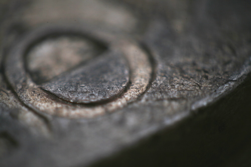

Lastly, here is the most magnified shot - the focus distance is probably less than 3cm here:
I can't give exact figures for the cost of the set-up the OM lenses came to me from my dad when he gave me his old OM-10 camera when he went digital but I've seen both go for less than £20 each on E - bay. The extension tubes and the OM->EOS adapters were cheapo Chinese efforts about £10 - £15 each.
