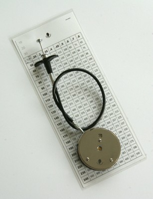

@MrDrizz having made several pinholes over the years I eventually succumbed to buying one of these
Whilst making a pinhole is not too hard, making a decent shutter, especially one that can be operated at at faster speeds I found to be a bit more of a challenge
That's fantastic and now on my list for the next build/upgrade.
