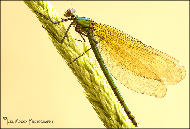

Agreed, I shoot Macro with a Sigma 105mm f2.8 lens and the area around f11 give or take 1 stop is the best for dof I've found
Like this - 105mm and off camera flash @1/4 power
DSC00239 Jolly Green by Les Moxon Photography, on Flickr
Tubes are a good cheap route into Macro and if you have a 50mm lens then - if cost is an issue I would use a tubes/prime lens combo
However: as said on certain sites the 105mm sigma goes for around £200-£250
