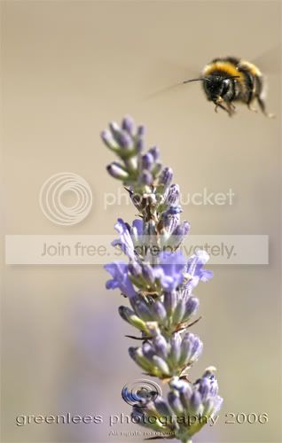

Noah has had some pretty good results with this very lens - I'll try to dig up his most recent buzzing escapades!
Edit : here we go!. Pretty nice, eh?

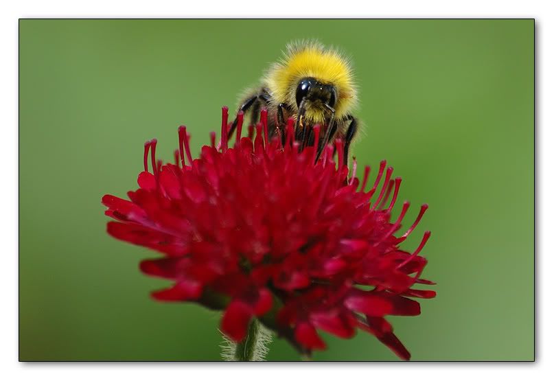

Hacker, this is an amazing photo you took with a close up lens. Can you tell me how you set it up and set the focus?
This was handheld and I focussed on the bush, luckily I fired the shutter at the right time, I was just starting out macro when I took this and there is a lot of trial and error (and a lot of deleted shots!)
When shooting macro/close up I would always advise manual focussing and either rotate the focus ring or move back and forth using small movements to keep the subject in focus.
