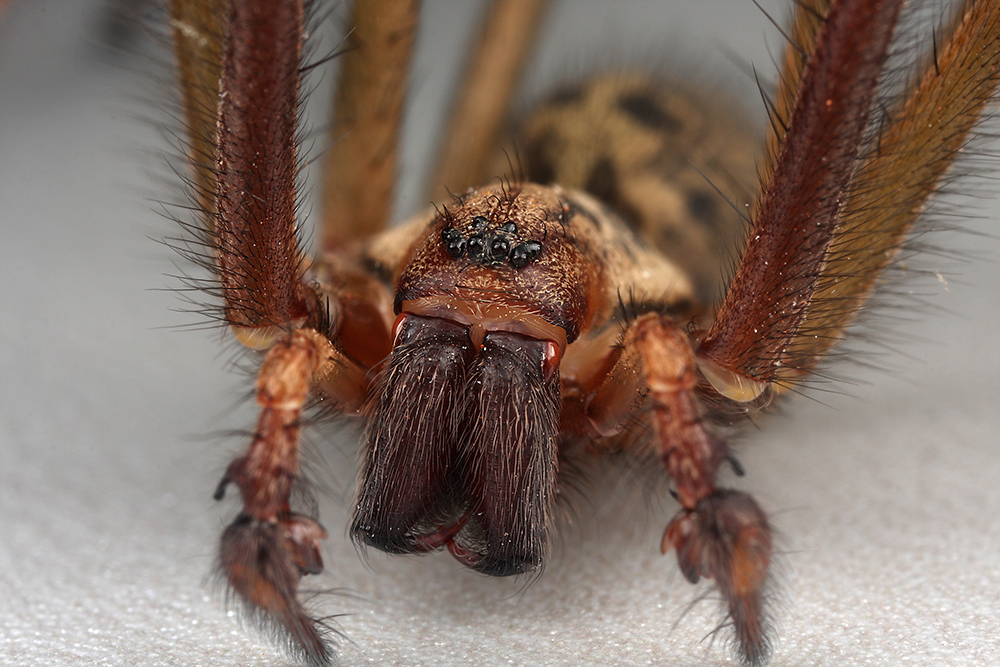

It largely depends on what you are going to shoot,if insects flat light is unlikely because the many angles of the insects body and the way the light hits it,natural shadows are caused by legs,antenna etc and the highlights usually form on the insects body nearest to the light source.This is amplified by the extremely short DOF and extreme light fall off if the exposure is all flash and no ambient.This house spider shot is an example of this.I use an MT-24EX twin light but have it set up with a home made diffuser sheet to provide flat even light.
flic1610 by michaelkilner, on Flickr
