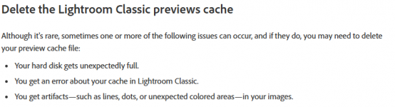

Hello again - so I think this is sorted.
I viewed my RAW files in Canon DPP, Fastone Image viewer and Microsofts W11 "photo" viewer and they were all displaying the images as expected, so I deduced the problem was Lightroom :-(
Then I found this advice in a document about optimising performance.
So with some trepidation I deleted the previews cash file and bingo everything seem seems to be right in Lightroom land again :-)
This is the whole document which I think has some good advice even if you need to read it 5 times to understand what it's on about
The only downside to this is the loss of all the previews, but they re build each time you open a new folder of images.
