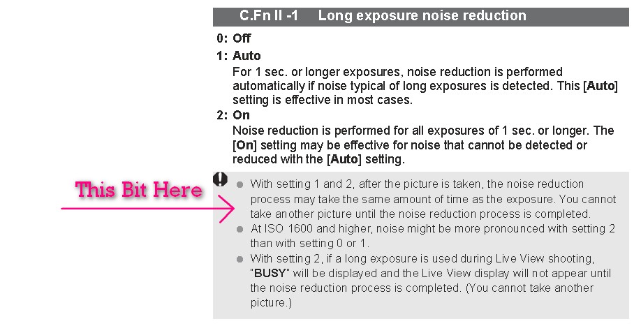

Let me try this again....
The LENR exposure does prevent you taking another image until that second exposure is complete.
Try p.208 of the manual.
Look, this bit....

Look, this bit....
This is clearly camera specific as my manual says...
"shooting is still possible as long as the maximum burst indicator in the viewfinder shows "1" or higher"
the comment with regard to Live View shooting is the same though.

Well, I'll be ...... Every camera I've owned with LENR has been the same as the 7D.
How on Earth do they do that? Unless they do the dark frame in multi-parts.
