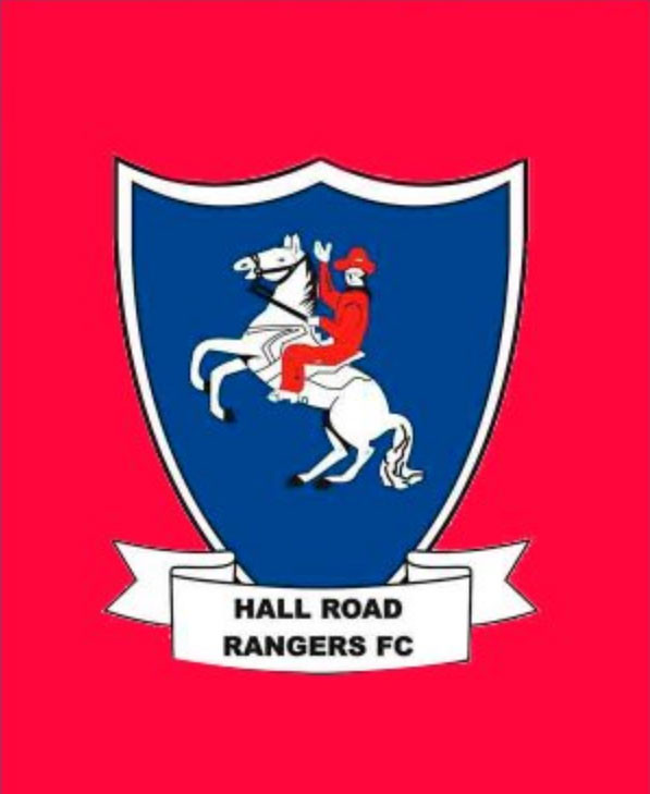

im trying to have a play with a logo , not mine it is the local football club im trying to make the cover better
i have the logo basically it is a white square with a badge style ( black outlined in the middle with a horse in the middle of that
is there a way to remove the outer white with out pasting the logo and the painting aound it on the cover
just trying to smarten it up
it is going on a colour background so it looks daft
althoug you cant see it is a white square around it
Alex do you mean transparent on the outside of the logo
Edit ah see youve added the logo now
yes i did mate
basically i want to lift the logo off the white back ground and add it to a cover , instead of it having a white square background on a blue blue cover
EDIT
just added the front cover now aswell
Here go Alex, I have the psd file if you want it, its seems a bit jagged though, if your using PS to make it remove the bg layer assuming its all on separate layer, the use merge down on the layers, not flatten image as that will make the bg white, and save it a transparent gif using Save For Web
It will always be jaggy if you use the selection tool, the one I posted is transparent but jaggy, I'll see if I can remake it for you
Alex this is pretty easy to do yourself.
Open the logo in PS then duplicate the layer, now select the white background and hit the delete key.
Next drag the background layer to the rubbish bin to delete it, and save the remaining layer as a PSD file if for a print or GIF for the web.
Now you can open that file at any time and drag it onto a new background of your choice.

You duplicate the background layer by dragging it to the little curled page icon in the layers pallet.
I used the magic wand tool set to contiguous and a tolerance of 30 then holding the Alt key down click around the white background.

When you have the selection of marching ants try expanding the selection by 1 or 2 pixels to just cover the edge of the black before deleting the background. This should remove the white ring. Try feathering it by 1 or 2 pixels as well to reduce the jaggy effect.
That wont work as its selected the approximate jagged pixels, all that would achieve is make the outline jagged but thinner, (would work on Vector or rasta but not in this case) and feathering will make it worse, best way was fill the white with the colour of the page :thumbs: as I assume Alex did
